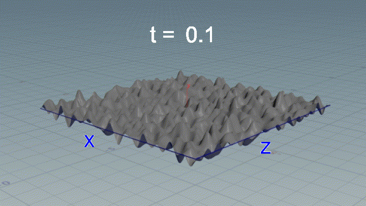

scalar noise, vector3 parameter
Perlin noise can also be generated from an underlying three dimensional grid. That is what happens if the noise() function is called with a vector3 argument. In the following example, I've used displayed noise as a function of the first two components, with time as the third component.
float t = 0.1 * @Frame;
vector v = set(@x,@z,t);
float @y = noise(v);
